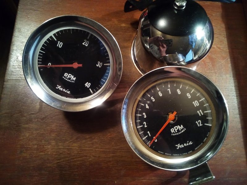

Been using a vintage faria tach of the era. 12g. works great. (yeah I know I dont need the latter half :roll: )
So wondering if I could run 2 tachs. Could I run another one under the hood?

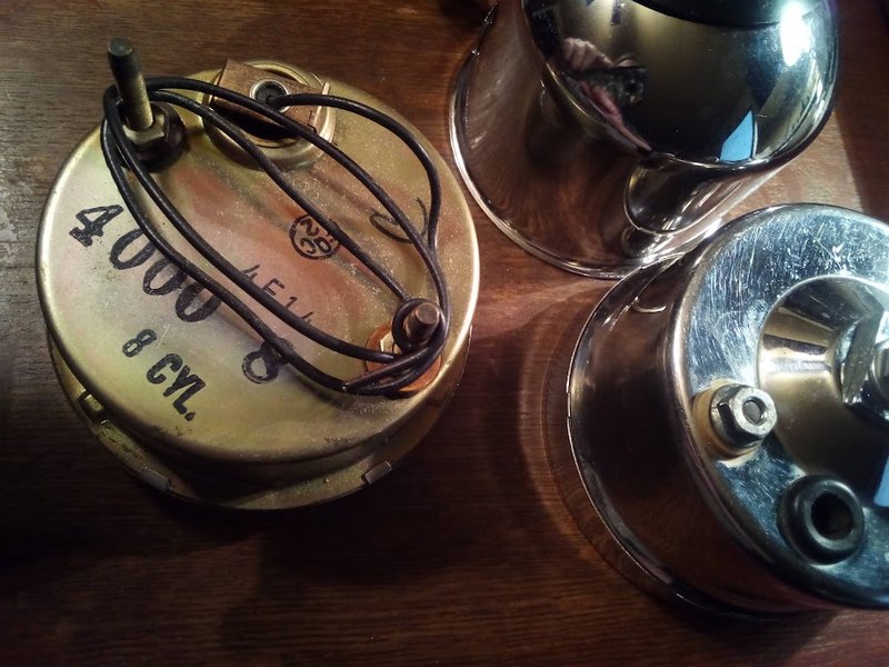

if so would it hurt this 4g tach ?I bought another similar tach (except its 4g )to get the mount cup off of. both are 8cyl tachs. I'm guesstimating 6gs would be back at the 0 peg. I may go a tad past that if my rev limiter ever failed but I have it set a tad under 6g I think. My cam is all in @5600 & I rarely get that high,but I could miss a gear someday. so I didnt know if the needle hit that peg would it hurt the tach?

Is that what these 4g tachs were for ? flatheads? I see them all the time & wondered what they were for. You got any idea what this 12g was for? I have seen one other one in a pic of a box of old tachs a guy posted one time. & still I wonder what 8cyl engine wound up that high in the 60's.
But yea Joe it's just laying around here not in use so I thought it would be a good one to see the idling & all the lower rpms when setting carb,timing etc. because the numbers are spread out a little better & easier to see & I got a steal on ebay for 29 bucks. Caught the big bidders napping I guess because the cups/brackets usually bring more closer to 100$. Guess they didnt see the cup,,,I saw a cup/bracket similar to the one that came with it sell for 139 bucks not long ago .
Just an assumption. Stock flatheads ran out of steam around 4K.
Only engine that could turn 12K in the '60s was Cosworth Formula One, as far as I know.
