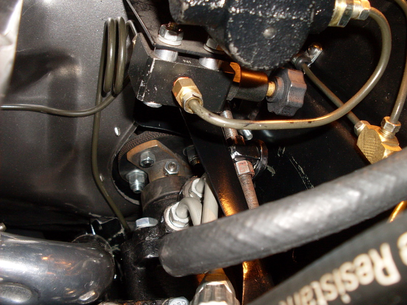

I have the borgesen box, & I used the stock z bar, but a highly modified z bar .took a lot of cutting ,testing ,& welding.as far as I know I'm the only dumbass to do it so I would not recommend it . I have dougs headers . but mainly the problem I had was the box clearance with the z bar. with the hyd lines in the way I made a guard to cover them so the clutch linkage nut that attaches to the rod doesnt get on or touch the lines. then I had to get the engine sitting just right & I still get a vibration when backing up a hill or too fast, I can feel the vib,, feels loud like a header. theres lots of pressure on that zbar so you gotta beef it up good if you cut & reweld it.
Hard to see in this pic because its black but if you blow it up you can make out the top of the z bar attached between the 2 nuts on the threaded clutch rod.also the black guard I made to protect the lines is L shaped.so tight in there it needed something between rod connection & lines. at the back of that guard is a clover above the rag joint barely visible,to keep debris from falling in there .rag sits in a tight little cover I made on the inside so I didnt want any rocks or whatever getting it there & locking up the steering.
If I ever have to pull the motor or trans bell again I'll go hyd clutch or cable. :roll:
