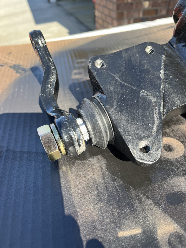

I am putting a borgeson PS conversion on my 65 Cyclone with manual steering. It appears that my pittman arm has a smaller diameter mount than the 1" sector shaft on the borgeson box. The arm slides on fine but does not sit deep enough on the sector shaft. Did the early manual boxes have smaller sector shafts? Seeking suggestions, thanks in advance:-)

No there was a larger one in 64. But should be 1" for all 65's .
Post up a pic.
Could it be that the pitman arm hole is gummed up and hardened ? Maybe get a small wire brush and clean up the splines in the hole.

Below is a photo of the pittman arm on the new steering box. The nut is flush with the shaft but I didn't torque it.

If nut & shaft are about flush I would think that is about right if you haven't tightened it all the way down. Think I put anti-seize on the splines because I saw guys breaking pullers trying to get their pitman arms off . So I suppose it has tapered splines? so it gets tighter & tighter as you turn.
But if it is just the gap above that concerns you, I think I remember that, & thinking their rubber boot should have been a little thicker .
Ok I went out & stuck camera under mine ,& I guess aimed it at the pitman arm a few times,fenders are off so I could reach in easy , took a few trys but I got a couple decent shots.
the first one shows some shiny shaft where I still have a gap above the rubber,confirming my memory. you might find something ,rubber,plastic or something to fill that gap at top before you torque it down;
but also better shots showing about how much shaft hangs out of the pitman arm nut .
