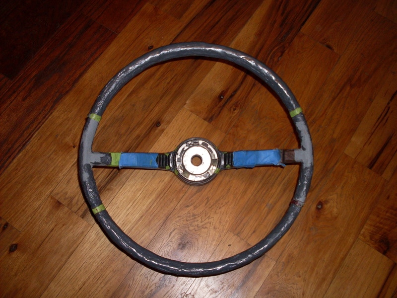

mine was cracked up all over & brittle so I completely encased the hoop in epoxy,& fixed cracks at the spokes base;
after I took 5'' out of the hoop to make it smaller;
a lot of sanding;
filled in the finger grips & made the hoop fatter,here it is with one side done;
painted
then covered it in leather;
