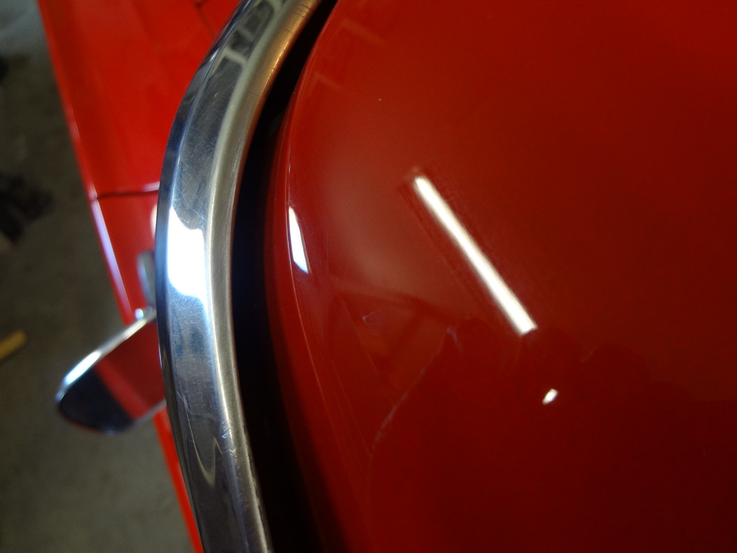

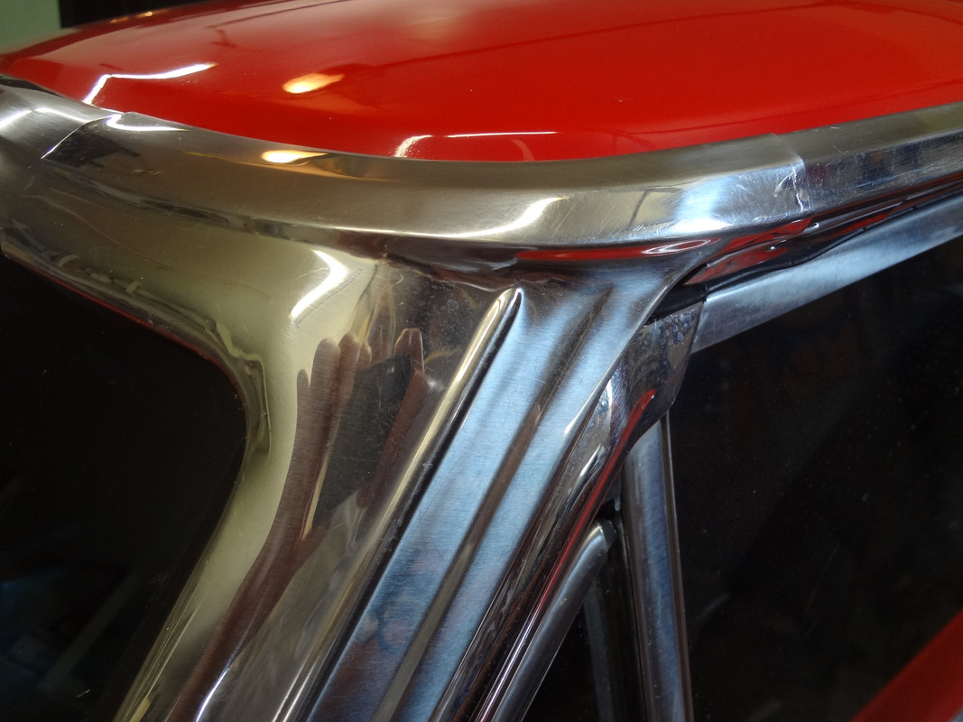

Here are a couple of pictures explaining where the water goes. The first one is on top of the car at the end of the drip rail in front. It's wide open for water to go down behind the chrome T which is pictured in the second picture.
The chrome T
Then the water must run down the top edge of the vent window frame and ends up in the car :( I'm wondering if I'm missing some kind of rubber seal or am I supposed to caulk up the opening behind the T.

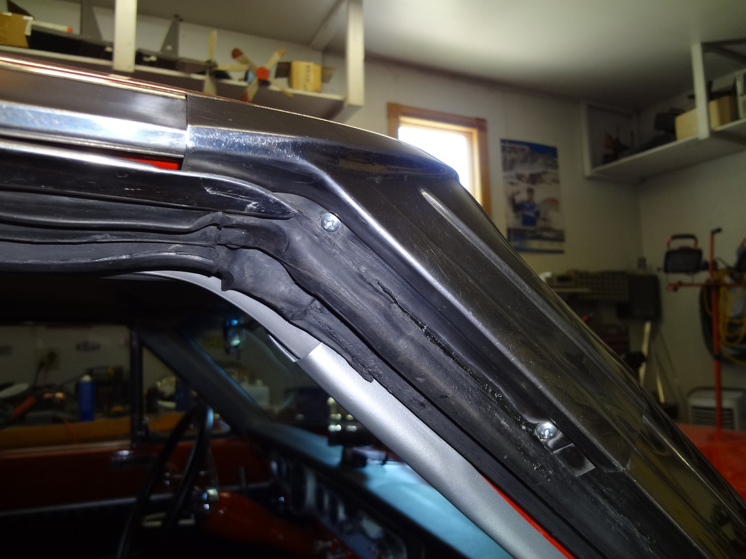

The vent window seal is entirely separate from the trim.
Any water entering under the "T" simplify runs down to fender/door outside of seal.
Any water that comes out from under "T" should simplify wash over the vent window to body seal.
Hope the images help not the best I know.

Thanks for the pictures Fred. I checked out what I have against your pictures and I have everything there. I did some more checking and found that the water was leaking behind the rubber seal that is under the drip trim and then goes down the door jam. When I installed that new seal I didn't use any sealer behind it. There is about 6 screws that fasten it to the door jamb and it had ribs molded into the back of the seal, so I figured it would be OK to just screw it to the jamb :roll: So now I took it apart and ran a bead of 3M weather strip black cement and sealer behind the rubber seal.
I'll wait till tomorrow and give it another water test.
