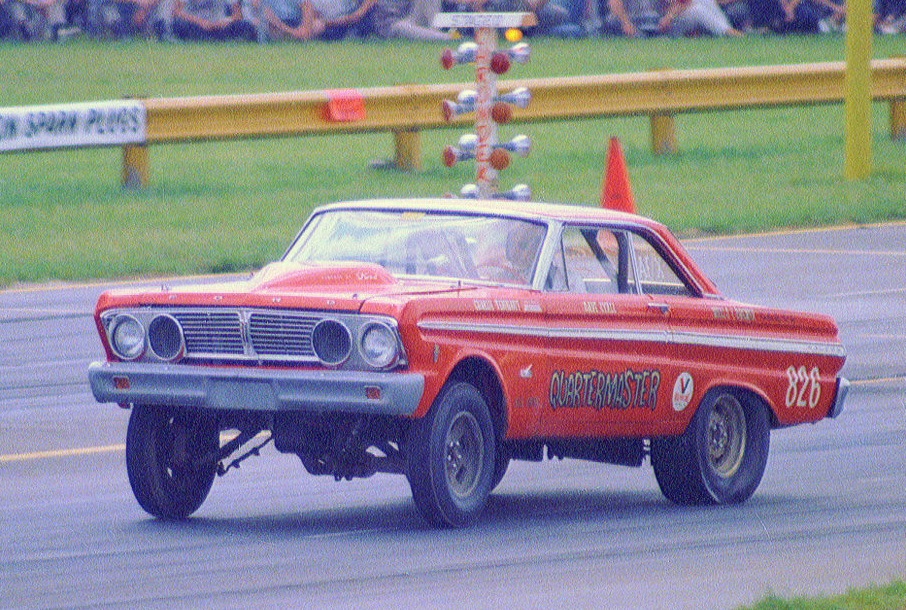

Joe, check out this T-Bolt ram-air setup on a '65 little bird. I dig the quad headlamp bezels & modded grille, almost looks like a '64 Comet in a way. I assume a tight seal w/ air filter would keep debris out of the intake on a track car? NASCAR runs hidden cowl induction w/o problems, wondering if this could work?
That looks great Joe!
The bolt on tear drop scoop I have is universal. So it doesn’t conform with the lines on the original steel hood. If you look closely you’ll see there’s an opening just forward of it. Free ram air!! :mrgreen:
I was going to make a metal plate to close that off but I like the thought of the cool air getting rammed in and exiting the vents on the back of the scoop.
