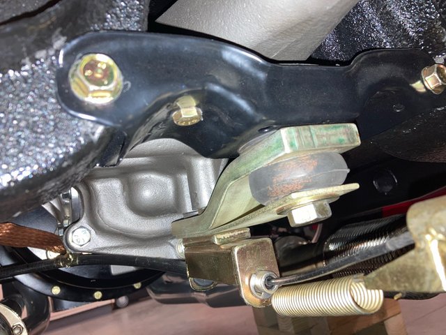

Joe here's a pic of the little bracket. I have a close up pic of the bracket somewhere, even had a spare one but i think I sent it to someone on here, or I could still have it. but it has a slot in it that holds the cable. the cable has a hat-brim like flange that fits in the slot of the little bracket.
also you can see I ran mine out the hole in the bottom that Fred may be talking about.It's just below where the floor would be. this is where convertibles cable exits I think, they're all different because of the bracing .
but mine doesn't work well with the 2 sharp opposing bends in it & I dont trust it. I need to re route it.

Thanks for the pic, John! Yes, my '63 the same as your shot of hole below the clamp. Here's '64 Caliente pic I took from the current auction.
Looks like cable exiting back of torque box, running through the crossmember, clipped on the back side with a retainer. Found all of the holes under the car. Looks like I only need the clamp holding the cable under the pulley on inside firewall, return spring for equalizer bar and retainer clip on crossmember. I see one odd thing; appears my equalizer bar is flipped to the passenger side. :?

I thought I described it to a T? has the slot, looks like my pic.
Posts: 2716
Re: Joe's '63 1/2 Tinkering Thread
Tue Nov 28, 2023 4:14 pm
The ring on the cable fits the groove in the bracket? Si? Postimage doesn't allow me to magnify your picture.
Rear floor pan....firewall.....toe board.....sounds close enough :lol:
Sold in pairs, bet you they are for the back cables but may fit the front one.
