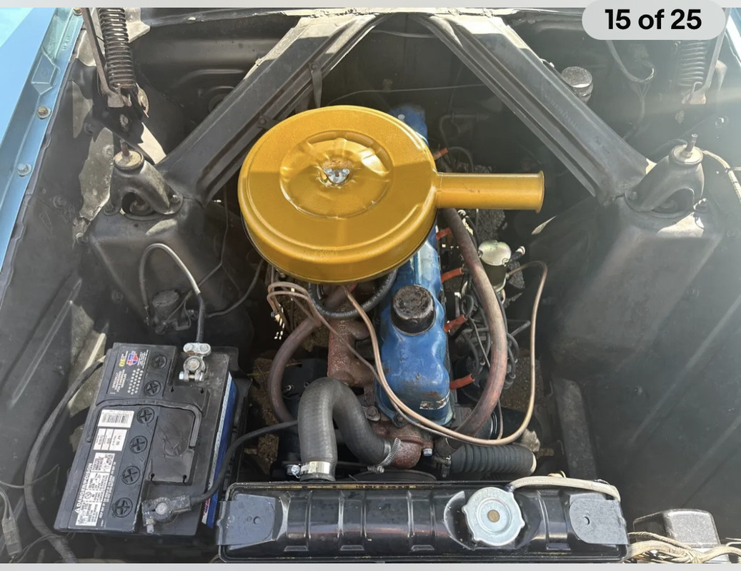

So I want to replace the two older red heater hoses and replace them with new black hoses. I have the 170 engine.
I couldn't find anything in the online manuals unless I'm looking in the wrong spot.
I am trying to avoid having antifreeze leak out onto my carpet inside.
What would be the proper order to do this?
Does the whole radiator need to be drained?
Does the heater core need to be removed?
Thanks for your help,
Doug

I was hoping it was something easy. Maybe I will just paint the hoses black. Lol.
I’m just trying to make the engine compartment look better. Not a fan of the red hoses.

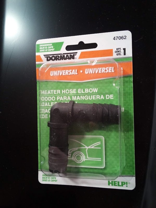

Posts: 7328
Re: Heat hose help
This is what I got,though I haven't installed them yet. but if you want to look better cut the old hoses up near the firewall use these & new hoses.
MY63COMET
Posts: 145
Joined: Mon Jul 03, 2023 12:27 pm
Re: Heat hose help
Post by MY63COMET »
Sun Oct 08, 2023 7:12 pm
That’s another great option. 👍
