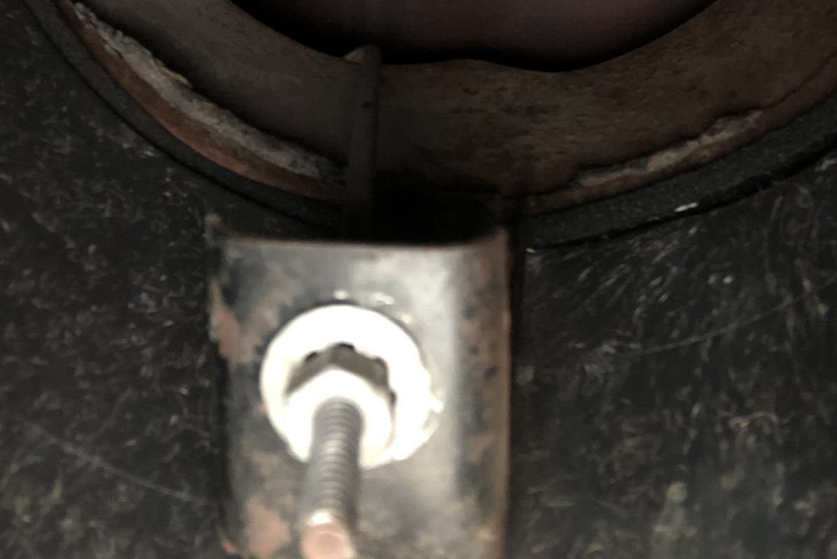

With one of the front fenders removed the drain will be visible, there is a drain on each side. Note red circle on the attached picture. There is also a fresh air plenum on each side under the dash, if you are lucky they will be solid with no rust through. If you are unlucky there will be penetrations from rust that is allowing water to drip on your feet.
