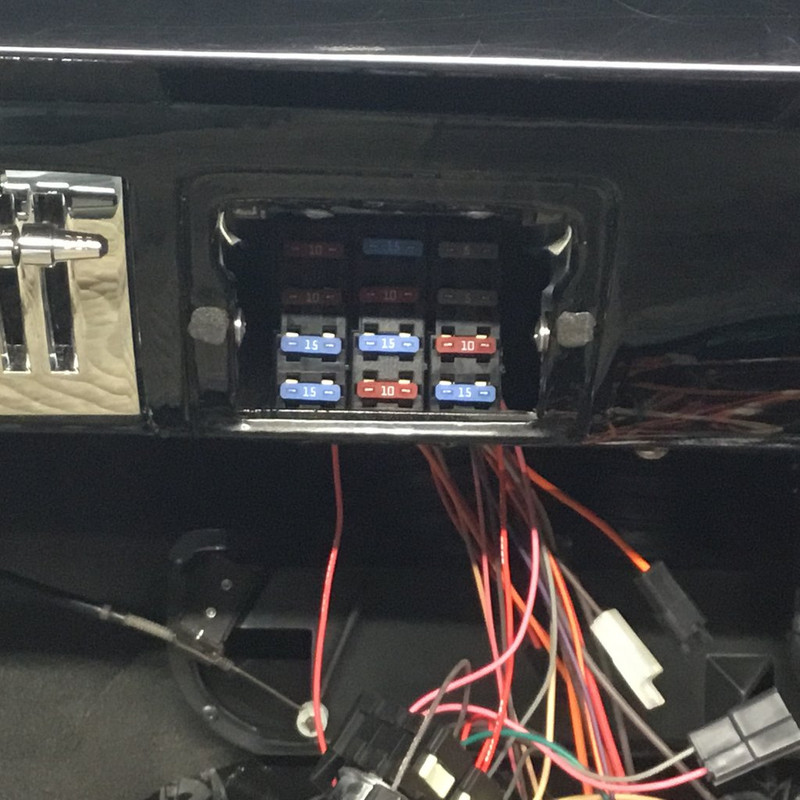

I used an American Auto Wire system in my Cyclone, overall it is a very nice setup. More than enough wire, complete with all the needed components. I installed it slightly different than most, ran all of the rear wires through the rocker panels and all of the front wires through the inner fender panels. The fuse panel is mounted in the glove box. I added relays for most high draw items to take the load off the switches.

There are a couple of relays incorporated in the fuse panel that are pre connected to the fuses. I added additional relays for items like headlamps, door locks, trunk latch, power windows, etc. if you look closely at the panel in the attached picture you will see the provided relays. I like this panel because it does not have the wires pre attached, they mount to the front of the panel making mounting the panel much easier and cleaner.

I mounted it in the glove box for easy servicing, The area under the dash and firewall is too crowded as it is, the stock harness did not have a fuse panel so there was no existing location. Everything is in the glove box except the external relays which are just below the glove box and the 175 amp main fuse which is on the frame rail near the starter. I did not utilize the cardboard glovebox liner, I fabricated a sheet steel replacement. I also hated the stock disconnect plugs near the master cylinder, I wanted to hide as much of the wiring as possible, so I welded up all the holes in the firewall and relocated the holes I needed. ( including the heater hose holes)

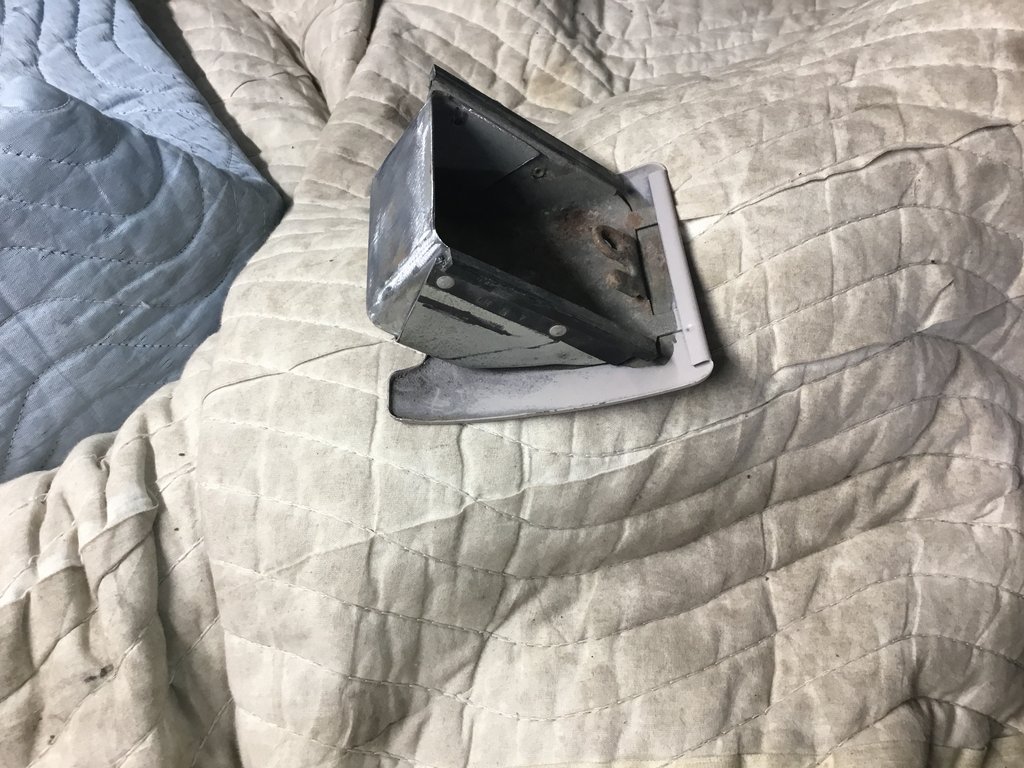

I prefer the Ron Francis kits, which is also universal but, smaller footprint for fuse box, cheaper, and IMO an easier kit to use. I have used a few on them without any problems. Used one for my Comet and the fuse box is small enough to put behind the ash tray.
Had to make the ash tray smaller but was a pretty easy install.

That is really slick and easy to access. Thanks!
