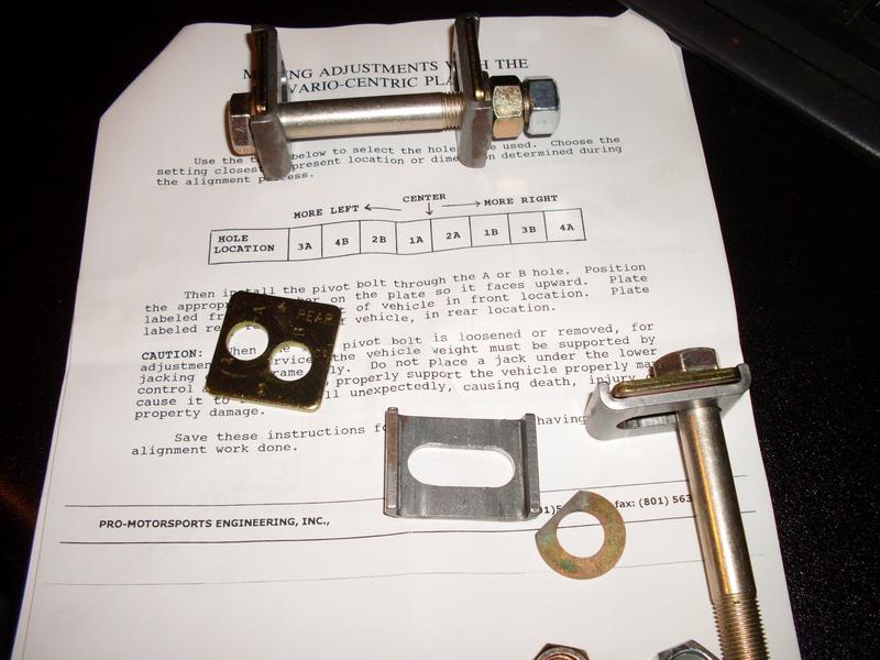

To me looks like it eccentric washer is used as a plain washer.

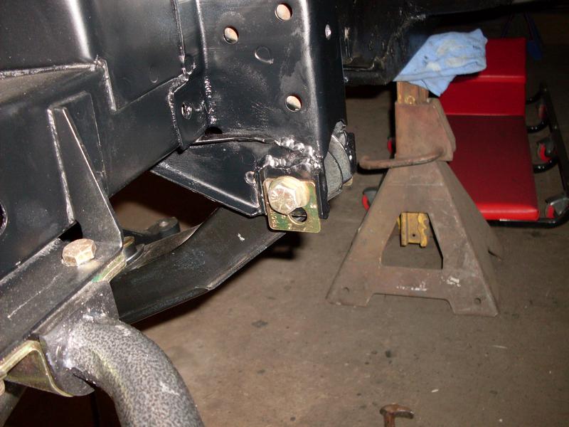

Welcome on! :D I agree with all who said it looks like a comet LCA & strutrod>>at least what I can see of it. Fred right ,that just like mine ,is called a vario-centric camber kit. it doesnt have the round eccentric washer things like in powerband's pic. kind of same principle but square OD. & there are 2 styles of the square kind .mine has only one set of plates that get turned to adjust the pivot bolt. & the other is similar but has several plates & you change them out . opentracker has those.
you weld the holder on the car & cut the car to match the slot , as you flip the washer it changes the hole positions,, with a chart to decode the lettered positions, sounds complicated at first but it isn't. ;
