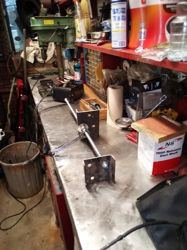

Yea you can jack up that far forward, motor is plenty of counter balance, or even without a motor . After I installed my monoleafs which were a lot stiffer I still couldn't get these wide tires on with suspension dropped so I made up a deal with what I could find on hand ,all-thread, channel metal scraps & a 30 year old virgin speed wrench. I thought about making a better more compact one to put in the trunk but so far I haven't.
it just pushes axle down away from frame rail;
