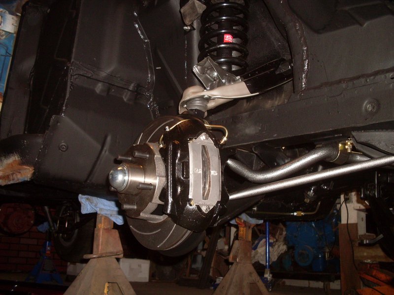

Re: Classic Ford Disc Brake Swap Kit
It's the one I used. good kit. you'll only need new hard lines & fluid . so yeah it's tried & true by many.
It's also a great time to add a new hard line to & on the rearend & the hose , & new rear wheel cylinders for a completely new clean hydraulic system,throw in new rear brakes for peace of mind.
the only thing I changed was the 2 bolts holding each cover over the brake pads,they had 10mm heads, I used some with 3/8'' heads. & not that I didnt have a 10mm socket, I have buckets full of em,,, I find those things everywhere,,,
but I didnt want any metric heads on anything.

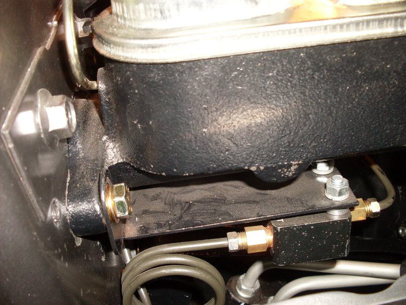

No you dont have to get new hard lines but 60 years is a long time & they could have all kinds of crud in there, that could hinder the flow or contaminate the new calipers. why would you spend over 700 bucks & not spend another 10-20 bucks on a new line to make it all new up front? I juust went to oreillys & got pre made lines & bent them myself. they have all different lengths up to 60''. I think mine turned out neater than factory lines > especially near the heater motor
also the kit comes with a bracket to neatly mount the adjustable proportion valve under the MC.
I used the pre-made lines on the rear too. it took 2 of the 60 inchers & a shorter one,I cant remember what it was, I got it a little extra long & made some loops. I remember thinking Groover & Jimscyclone would be proud of me for using math & pi to figure out what diameter of pipe to wrap it around to make the loops to use up the excess for a perfect fit.
I have seen some factory systems use the loops to help with shock fatigue or something so I thought it was a good idea.
the brass couplers to put them together were about the price of the long lines but altogether still cheaper than buying the ones made for the car or buying a double flaring tool & doing the flaring myself & I didnt have any leaks.
& if I screwed up a line it was always the last shorter one so didnt have to re bend the whole thing. I think that may have been the larger ones I used for fuel lines, they were not as easy to bend
